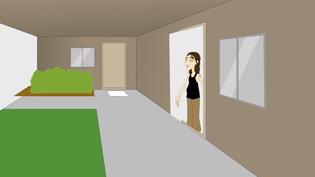

I did as you said, but did not achieve the desired results. Here is what is looks like before:

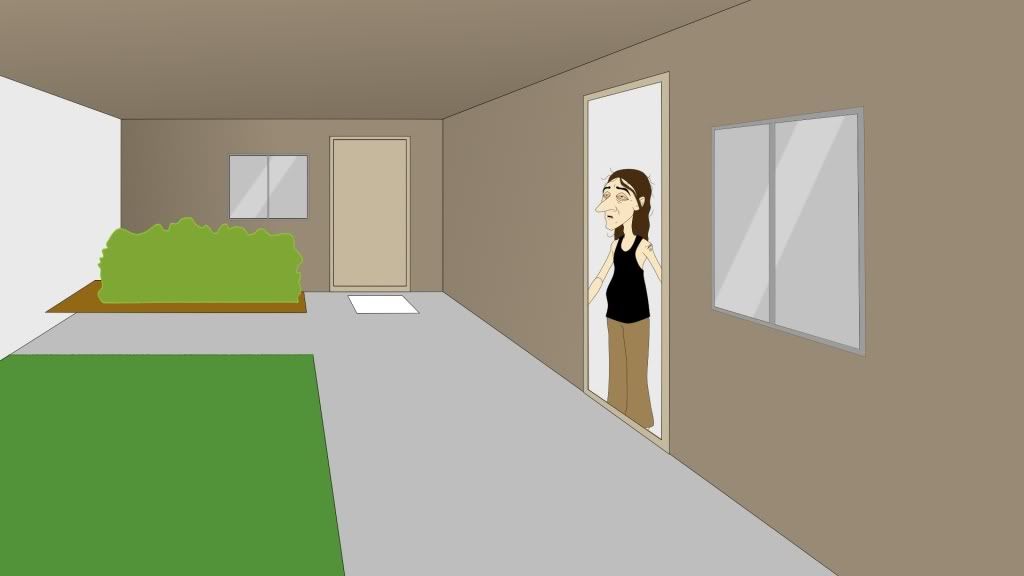

And here is after:
It revealed the arm, but covered the apartment exterior.
