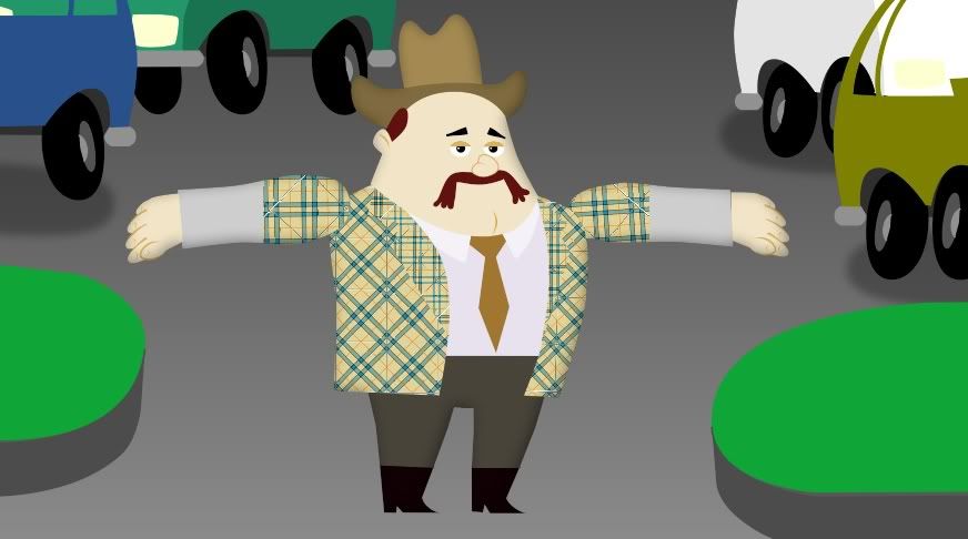

I'm having this problem with a character where I've used a tiled image for the fill on his clothing:
The gray on his sleeves isn't there when his arms are down- it appears the image only get tiled/repeated for so far and then any shape that goes outside of this area is getting to the gray... Is the only fix for this to use masking instead?

I'm not sure to understand your problem, but remember image textures only moves with bone strength, so you must add some strength to the arms bones.

Since this is nearly un-fixable, I'd use the alternative method of image layers masked with vetor layers, both bound to the same bone.

thank selgin- I didn't realize bone strength needed to be on. I normally manually bind points and don't use it.
