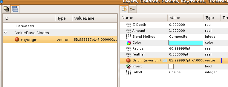

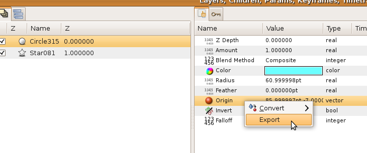

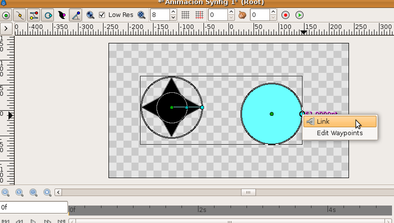

Each parameter can be "exported" that means that the parameter is exposed to the Document level now. When exported it is shown in the "child" panel and can be selectable there. Later if you select any other parameter compatible (you cannot directly link a vector to a real parameter because it doesn't have sense) and right click on it, a "Connect" menu option is offered. Once selected, the parameter gets "connected" to the exported one, so both share the same animatable value (modify one the other follow and viceversa). This export-connect opertation is simplified when you interact with different parameter handles in the canvas window. Select two parameter handles from two different layers (placed anywhere in the layer stack) and over one of them right click and select "Link". They are automatically linked. None of them are exported but are internally linked. You can later export any of them and all the linked will show the exported name.
Click to enlarge:
Export a parameter of the layer.
It is shown in the child panel
Same operation but with the radius selected fomr the star and the circle layers.
Hope it helps.
