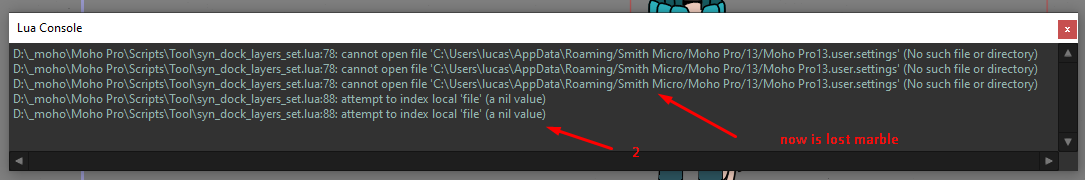

The link now works, thanks! But I have a problem in version 13.5: This problem appears :(
I duplicated the folder and renamed it to Micro smith, problem 2 appeared.

lucasfranca wrote: Fri Aug 13, 2021 3:01 am The link now works, thanks! But I have a problem in version 13.5: This problem appears :(
Okay, I've updated it for v13.5.
