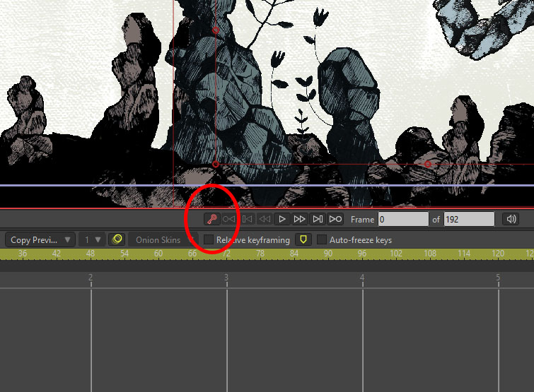

Hello.
please add this important feature to moho. some time we need to turn it off.
https://pasteboard.co/KbfjfYC.jpg

Suppose you animate a scene and now you need to import an object and adjust it with character position in frame 250. In this case, going to frame 0 does not help at all. Because I need to adjust with frame 250.
And there are many situations that require this.
Besides, going to zero frame is painful when the scene gets a little heavy.
please see autokey feature in some other software like maya and 3ds max

Perhaps something like this...

Maestral wrote: ↑Thu Jul 15, 2021 5:08 am Perhaps something like this...
that is good alternative way.
