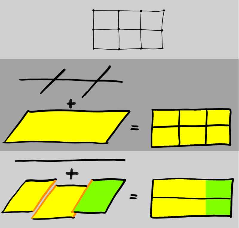

I recommend to change your style of working. Instead of welding separate lines, think in terms of closed shapes which get stacked. Much easier, less confusion, more satisfaction.
See this example. The grid you have could be created in several different ways. For me it's easiest do create just one shape with a colour fill, then put more intersecting lines on top. If you need to have different colours, use the second approach: separate shapes, and their outlines switched off where needed (orange lines).

slowtiger wrote:I recommend to change your style of working. Instead of welding separate lines, think in terms of closed shapes which get stacked. Much easier, less confusion, more satisfaction.
Thanks. I have switched to staked shapes for the most part. Your drawings are very helpful.
