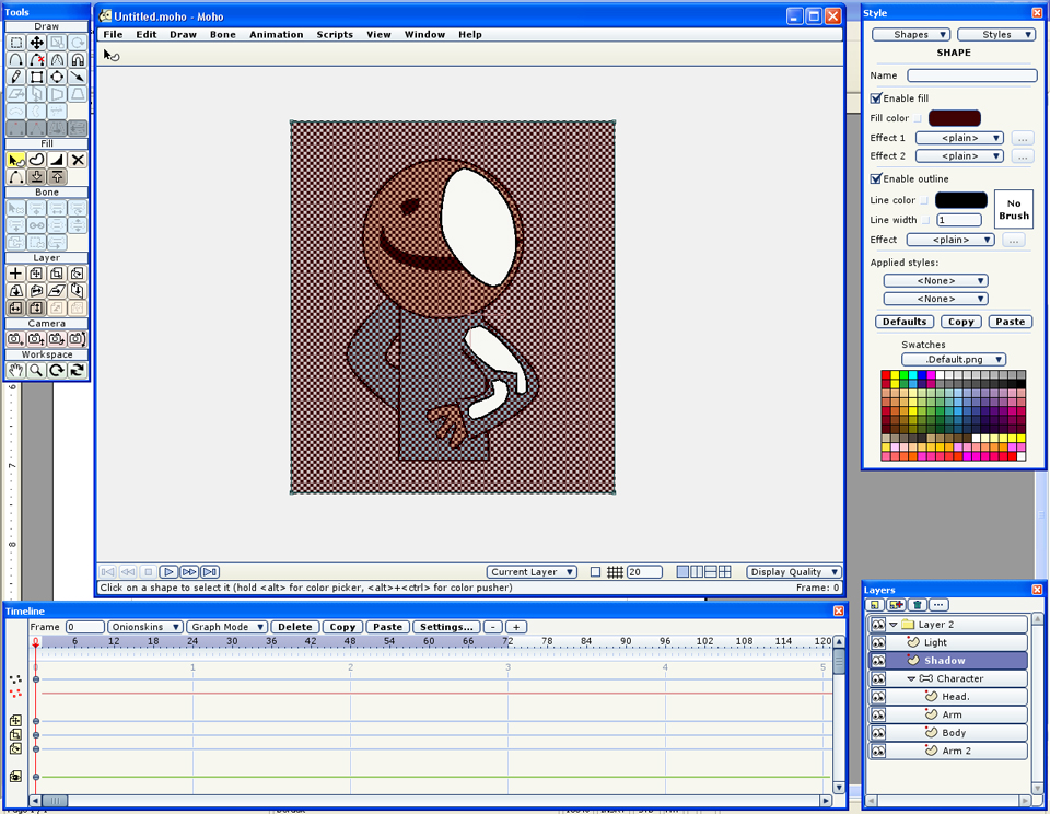

Well, here is a new question. I've been trying to figure out some masking issues. I did some basic masking tutorials, but I haven't been able to find a solution to what I am trying to do. I made a screencap of an example setup.
I have a character that I want to add shadow to. The idea was to have two lighting layers, one shadow, that will be multiplied during rendering and one light that actually has to mask a hole in the shadow layer so the original color will show through it. Then, last but not least, the entire character has to mask of the excess shadow color that is outside the character. I hope I made clear what I am trying to do. Could anybody help me out as to what masking settings should I use to get this effect? Thanks for the help!

I figured out the masking thing myself, but I still don't quite fully understand how it works. Mostly trial and error for me. I have a new problem though. Whenever I draw a line with the freehand tool, not closing the shape, the line vertices keep snapping towards other objects, even while I'm animating. Is there a way to "finalize" a shape, to prevent this from happening?
Another problem I keep having, as soon as I turn on the 3D camera and start animating, all the shapes start to pop in front and behind each other. Am I doing something wrong or is this a common problem with moho? Yes, I'm still using moho...
