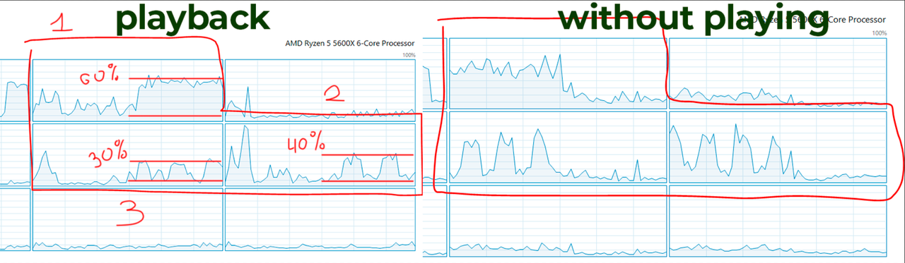

Good afternoon, please tell me why the software uses only up to 25% of the logical cores of the processor when playing animation in the viewport?
And even these 3 logical cores are used collectively loaded as one logical core at +/- 130%.
Is it possible to somehow make Moho work at 100% of at least these 3 logical cores?

But even so, with 3 origami in a scene for a serial project, the number of frames per second drops from 24 to 13-15. Yes, it's not a little. This is enough for comfortable work, given that you can disable unnecessary settings and work only with those that are needed at the moment.
But as a technician, I'm more interested in how to increase productivity. And it is clear that the software can use more performance than it allows itself.
