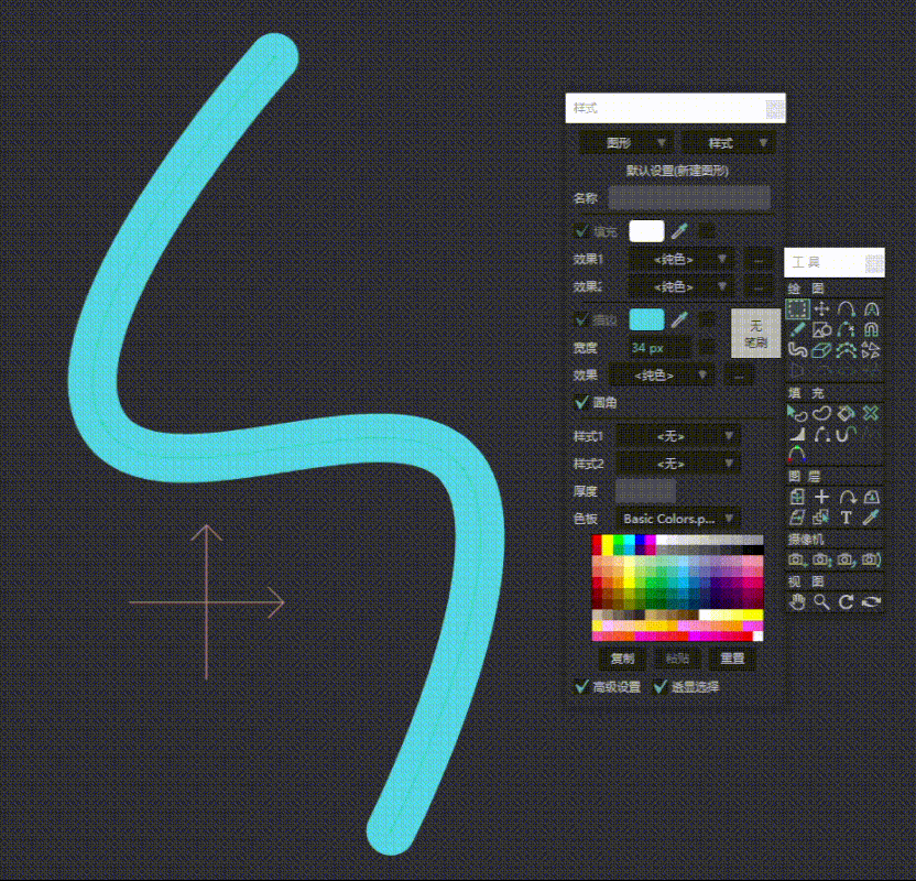

:shock: I have also encountered similar situations, which really drives people crazy. Because I often need to perform complex operations on node curvature. :shock:
