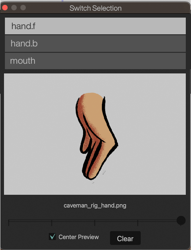

I think it would be great if, instead of shuffling around in endless sub-layers till you find the Switch layer, click on it and then get the appropriate selection in the Switch Selector Menu, we could select all available Switch Folders from the regular Top Bone or whatever Layer.
A possible solution could be something like this in my super crappy, quick and dirty Mock-Up: No matter where you are on a rig, the Switch selectio menu always shows you all available Switch Folders and you can select them from there and then conveniently change the images.

hayasidist wrote: ↑Sun Mar 26, 2023 5:29 am like this? https://www.lostmarble.com/forum/viewtopic.php?t=34078
I don't know the tool but this is just from the built-in Switch Selector with Thumbnails. The only addition is that you can select the Switch Layers of a hierarchy directly from the Window as well.

JoelMayer wrote: ↑Sun Mar 26, 2023 5:53 am I don't know the tool but this is just from the built-in Switch Selector with Thumbnails. The only addition is that you can select the Switch Layers of a hierarchy directly from the Window as well.
I would like this feature to be added to Moho.
Nearly every time I activate the nifty "Switch Selection" feature, I get this message: "The current layer is not a switch layer." And then I'm like, "Oh, yeh. I'm on the main bone layer." And then I have to find and select the switch layer and start again.
Being presented with a convenient list of all the switch layers (within the selected bone layer) would be great.
Bonus idea: after the Switch Selection feature is closed, make the character's main bone layer selected by default.
Moho is all about speed, and these features would definitely speed things up for me. A few seconds here and there add-up to minutes after a while.
