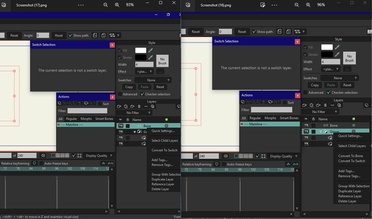

This is what i get in right click options...
https://postimg.cc/yDvdzmZm
Is it possible that may be those options were available in older moho versions? I am using 13.5.
Edit : To be more clear, i do get the quick actions, and the other options you mentioned are there. i just that i thought there is a "mask inside / mask outside bottom layer" option as well, so was looking for that exact option.

:o umm... that is weird. It does not show up in mine for some reason. So i guess its broken, i may have to reinstall.
Meanwhile i have created this blank file with group and bone layers for test. Could someone please check if it shows up with right click in yours to confirm... (i am using 13.5)
File : https://drive.google.com/file/d/1PHtEXt ... share_link
My Screen : https://i.postimg.cc/wTLwYRGt/test.png
Posts: 4006
Re: Mask Inside Mask
it looks as though that's a 13.0 screenshot??? or maybe an earlier 13.5??? Can you check you're actually using the latest version - 13.5.5

Got it, its 13.5. Didn't noticed that, thanks for pointing out :)
