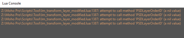

hi.
one of my scripts that I used this method give me error after update. any body know about new api?
another my script for replacing missed files don't work for same reason

I'm going to update mohoscripting.com soon for all new changes, but to answer your question for now I can say that the following methods were removed in 13.5.2:
Code: Select all
class ImageLayer:
	SetUniquePSDLayerID(layerPSDID)
	UniquePSDLayerID()
	SetPSDLayerOrderID(layerOrderID)
	PSDLayerOrderID()
