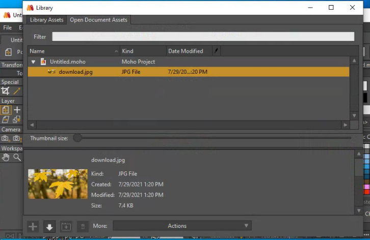

What I need is: by scripting, after file importing in document library (image below), creating some category folder in this library (Image, sound, etc.) and put the file reference into this category folder.
For example this "download.jpg" put into [Untitled.moho->Images] folder

Since there is no scripting access to the Library, Victor's suggestion is probably the closest.
File>Gather Media collects all the referenced files in the document and puts them in Images, Audio, etc. folders with the Moho file.
To speed this up, enable Edit>Preferences>Documents tab>Open and switch to new file after Gather.
Then you can just File>Gather Media and add to the Library.
