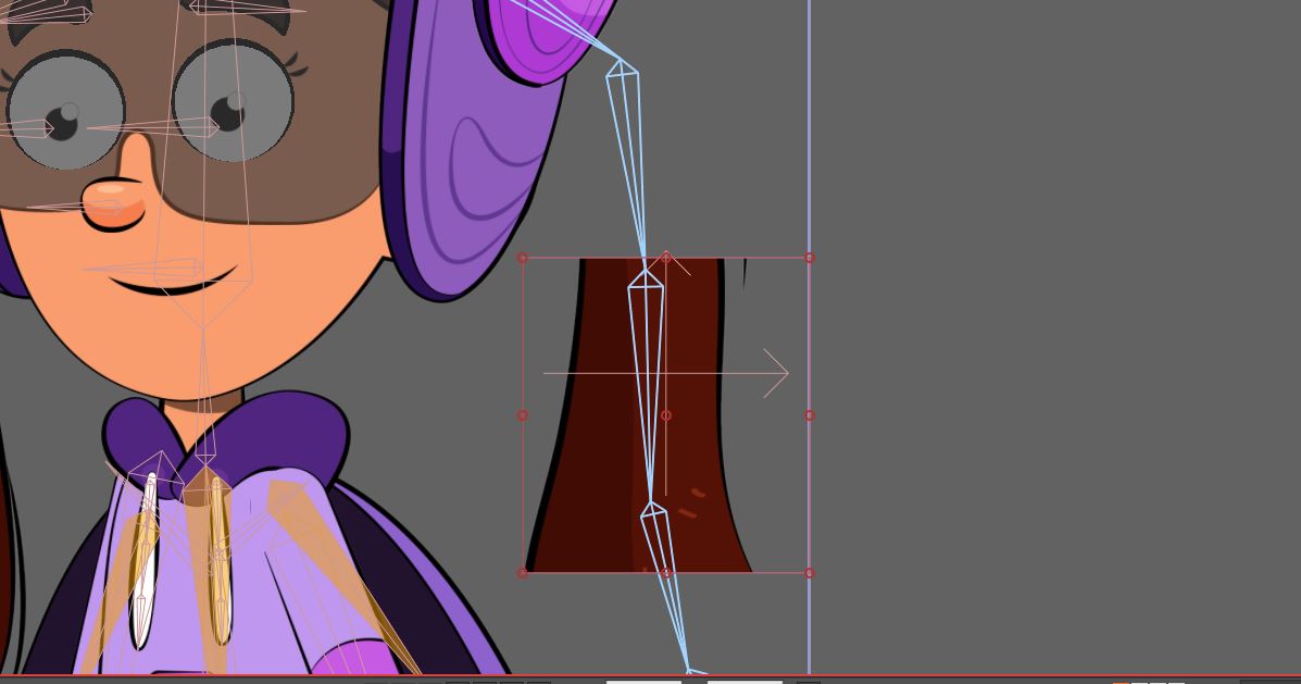

hello
it seems in some situation it work and in some other situations it does not work.
I have a file and I attach screen shot of it in moho 12.5 and 13.5.
please do not test it in simple image.
moho13.5
moho12.5

The Crop tool appears to be working in 13.5 here.
Is there a Smart Warp involved with the image? Smart Warp is not compatible with the Crop tool. (This is true in Moho 12.5 and 13.5.)
If that's not it, can you post an example project where this is happening?

OK ... I am now seeing a problemo.
What I am seeing is when you have an image layer in a Bone group with one or more bones - there is no change to the image when then crop changes (even though the preview works) - UNTIL you move in the timeline or enact some other change which refreshes the display.
Feels like a UI update/refresh is missing?

Do you have steps for reliably reproducing this error? I don't doubt you; I've seen display refresh issues elsewhere in 13.5, but I'm still not able to see this.
In my test, I made a two bone setup with an image in 13.5 but the Crop is refreshing correctly. I tried this with the default binding and layer binding. I'll play with this a little more to see if I can reproduce the refresh problem.

Re: moho 13.5crop image not work in viewport (attached file)
Ok, I got it! For some reason Warp Using Bones was disabled in my example. When I turned it one, I could reproduce this error. I'll report it today.
(Also, I'm not sure why the option was off. This was a freshly imported image and the layer settings window was not open. So far, I can't reproduce whatever action caused this to be disabled. Will test this further later.)
No need. With SimplSam's input, I was able to reproduce it here, and I submitted a report to Lost Marble this morning.
Thanks for catching this one. Hopefully, LM can squash this bug soon. :)
In the meantime, I would just step fwd & bwd 1 fame after changing the Crop to force a refresh. Or, just ignore it; this display error should not affect final rendering.
