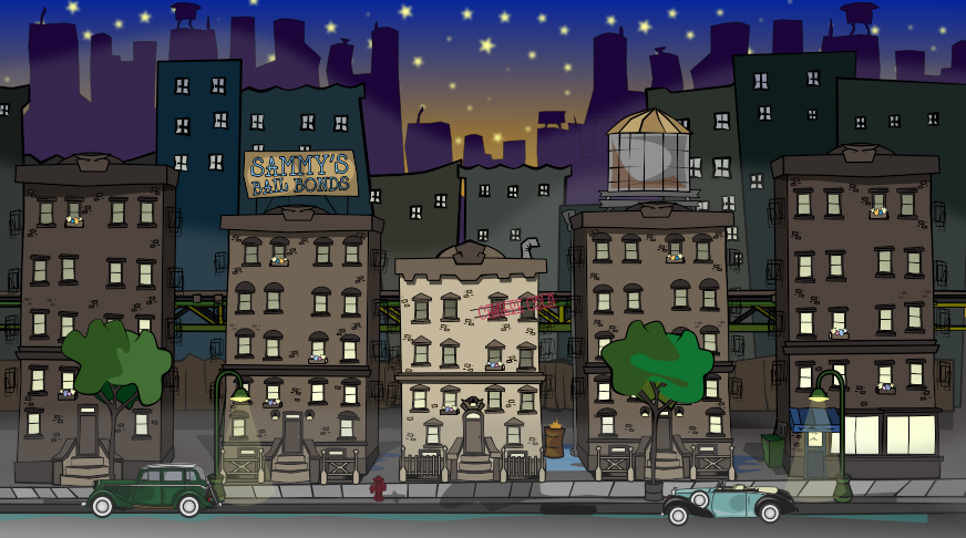

Here's a scene I'm using that's got a ton of points. When I made this at first it would take about 15 seconds to render a single frame but I did stumble upon an interesting little trick. When it was rendering the layers with all the windows and stars, the render window would show the layer pop up then make the stars and windows one at a time.
For this scene I didn't need each window or star to have a different color or shape effect so I created them all as one shape. (The stars in the background are one shape. The windows for the midground buildings are all one shape. The windows for the buildings in front etc.) Now the scene renders in about 7 seconds and when it comes to the stars and windows in the render window they all pop up at the same time.
I didn't delete any points in the artwork but by taking a bunch of the repetitive shapes and making them one shape it cut render time in half. I have no idea if this had any effect on the file's size. I'm just a cartoon hobbyist hack and I don't have any restrictions on render time or file sizes for a customer. So of course I it depends on what your individual needs are.
I did think about just using an image file but I ran into trouble with how it looked when I zoomed in. I am going to use an image file of this same scene with others for a scrolling background on a chase scene later.
