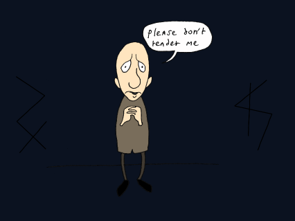

Now compare these. I've drawn this thing especially to prove my point and hope it will come across --
The upper drawing (TP6) was rendered with AS6, HDTV 1920x1080. The lower drawing (TP5) uses the same resolution, but was rendered with AS5. Take a close look, and you'll see that TP6 is slightly blurry when you compare it to TP5.
(Both drawings also have that bloody white line at the left that I despised so much in AS5: obviously one thing that didn't upgrade with the 'upgrade'.)
If these aren't clear for you, I can e-mail them in their original size (1920x1080) if you want. But in any case you should definitely see at least a difference when looking at the 'cross' at the left of the figure. Imagine a busier drawing, and the difference would be even greater -- I have some scenes where characters are in the distance: in AS5 you see their faces, in AS6 you don't.

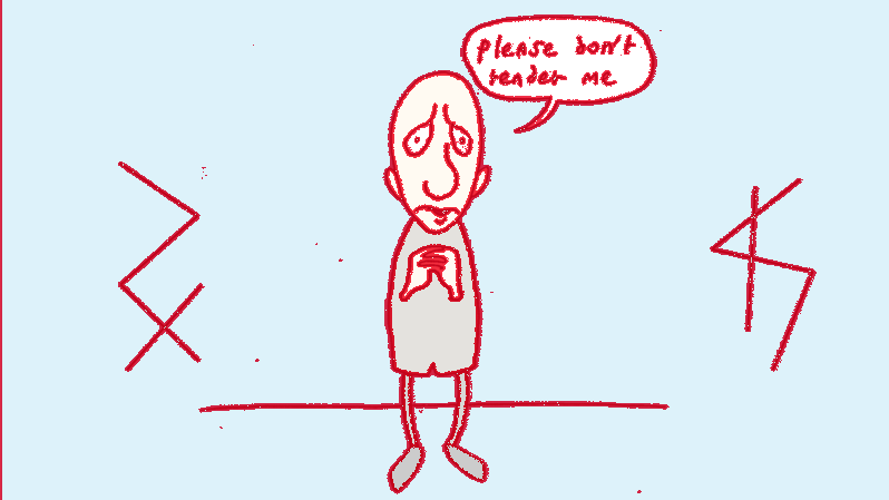

Again two examples, same character (this detail: 1/1):
The nose line between his eyes. The lettering. The fingers. The line he's standing on. Just everything.
Like I said, I'm willing to send you the images in their original size if you really need that to be able to tell they're different. Although I'm quite shocked you can't see it.
Posts: 6369
OK, whereas the first pair of images was identical, possibly due to resizing, the second pair is different.
It looks like your v6 image has been sharpened, and the v5 image not.

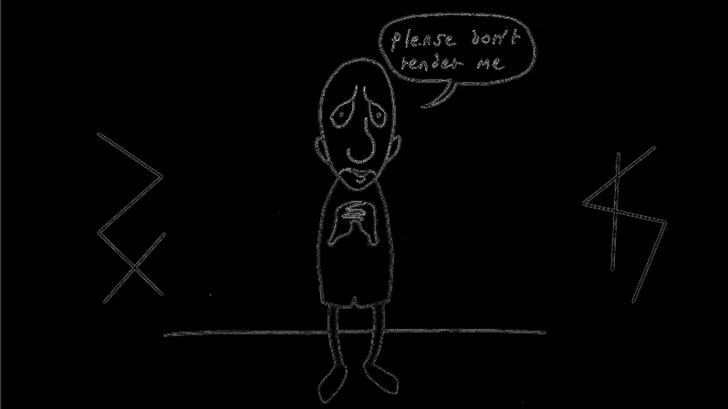

Honestly I didn't see any difference so I used the computer to do it. I saved the two first images and use compare and composite from Imagemagick package to see the difference between the files:
Just a straight:
Code: Select all
gives me:
Another type of comparison:
Composite with the difference method over a grey scale.
Code: Select all
$ convert TP61.png TP51.png -compose difference -composite -colorspace gray difference_gray.png
Constant stretch the result to enhance it.
Code: Select all
I obtain this:
Notice the mentioned vertical line on the left and the blurred pixels around the lines. Also the spots surprised me!.
