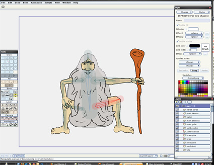

why do my legs not want to bind ? .. ive turned on "region binding"
they are not flexible at the knee , and when i move them , the top of the leg (at the opposite of the foot , i appologize for my english :oops: ) moves too , i mean it is not linked at the body ... the whole layer of the leg moves as i would like it was as a "real" body
so what have i missed? :(

Are you moving the bones with the Translate tool instead of the Rotate tool? I think you'd want to use the Rotate tool to move arm and leg bones.

translate or rotate tool are used to move the bones only, not the Image stuck with or?
in fact i think it is because i havent given enough strenght to the bones .. ?
sometimes it binds , some other it doesnt

I guess I don't understand what's happening here - the picture looks like the legs bend just fine. Can you post a link to your Moho file so we can take a look?
