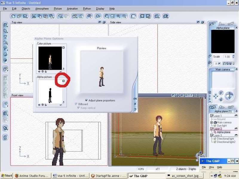

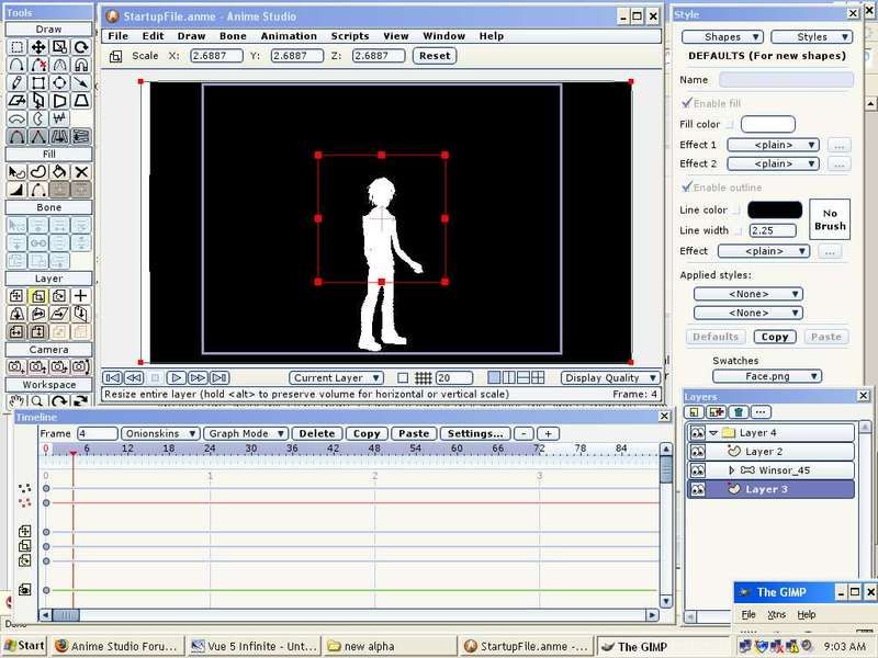

Render one pass to a file using png's normally. Then in a separate file have a group layer masking set to 'reveal all'. Layers 2 and 3 are black and white vectors that cover the entire camera view, their order doesn't matter. Winsor's masking layer is set to 'subtract from mask' Render to another file using png format. Try to keep the feet as close to the bottom of the camera view.
Import both files, Vue will detect the sequence pictures. If the alpha is backward use the invert to correct. Now you have an animated alpha plane. You will need to add the time line and move one of the plane's parameters to get the first key frame. I'm having issues the getting a codec that works. Some that work fine will not play in media player, older codec's give a grain in alpha whan rendering. I have a program that takes squence pictures and makes a movie out of them, If I could just find it :)

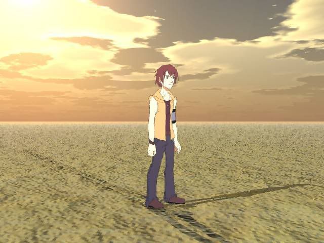

A rendering in Vue with 3 lights.

Ok - I got the mask to work and it looks good, but I can see a bit of the square around the alpha plane. Is this what happens or should i be able to make it 100% invisible? Thanks

What compression are you using? jpg works fine, png shows up from the alpha being in the format. I think.
Just use jpg seq if your doing animation.
