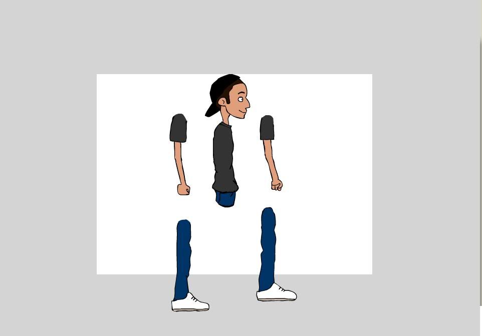

When I create my character in Flash CS4, i export it as an Adobe Illustrator File to import in Anime Studio Pro 6, however when i import it into Anime Studio Pro the edges between different paint streaks are transparent (holes in the edges)
Flash CS4 Draw
http://i781.photobucket.com/albums/yy96 ... 1268110133
Anime Studio Pro Render
http://i781.photobucket.com/albums/yy96 ... Render.jpg
Ive Tried optimizing the drawing before i export it, but that doesnt remove the gap between colors. This occurs with every AI file i import from flash. Is there a solution for getting rid of this gap other than retracing it?

Figured it out, Create a duplicate image that is completely the same color as the outline and paste it in a layer behind and export from flash as AI. File
