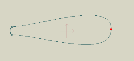

Is there a smooth arcing of points script?
Where points can be selected and then the action causes all the points to have equal distance between them and every point between two others is averaged.
Joined: Tue Oct 17, 2006 3:27 pm
I barely remember something written previously. A deep search in the Scripting forum might give you the answer.
Anyway, try to recreate the script manually and you'll find that the curvatures need to be adapted to fit the original curve. That lead into a multisolution problem... eventually without solution... unless you add more points...

I mean, BEFORE write an script or ask someone write an script, try to proof that it can be really possible to do with the current geometry tools. The example I gave you tries to show that with only three points is very difficult to average the position of the points in a curve without modify the curve's shape, even changing the curvature of the points.
Also think that a script is just an automation of a task, that should have to have an unique solution (as many equations as variables) and not a intelligent system unless you program it carefully.

Yeah! I see what you mean. That was educational.
OK! So the easiest solution would be a 5 point half circle tool where all the points would be on the circle.
