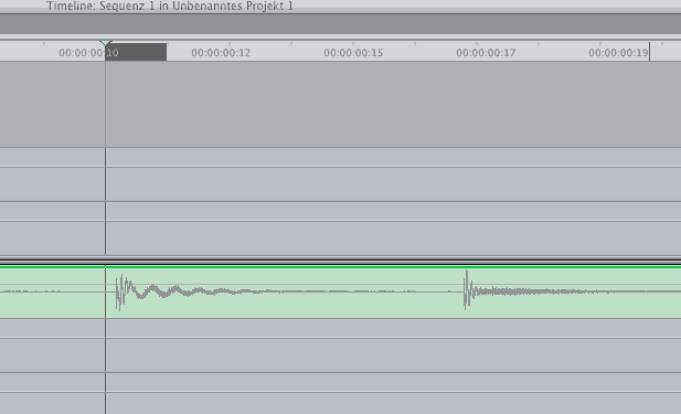

OK, since I haven't used this workflow yet I just did a test, loaded a soundfile into FC and searched for the right setting. It's easy, it's just one of the general viewing options: "Show audiotrack as waveform". The timeline looks, when completely expanded, like this:
See the grey part right to the time cursor line? That's exactly one frame.

Awesome, thank you sir ;)
Think I'll go with that if I can get some bucks. Way cheaper than After Effects too. Phew.
Thanks again, that's a big help.
