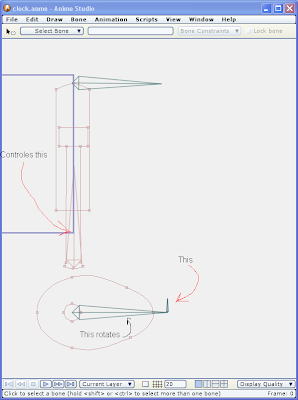

I tried to make a cam too, looks like you can not use position control bones, that are controlled by a bone that is moved by another rotating bone.

Here is a little picture of my cam.

I did try to attempt to get the clock to work off of actions. The action "resets" the angle back to 90 every time, instead of continually adding 360 to the number. Which makes all the sense in the world, but it was worth a shot anyways.

Bones can rotate "forever". The rotation continues to increase as you rotate it so you could just "wind the clock" on a later frame to make it repeat. A layer script could do it as well... use the frame number to increase the rotation of a bone. Or even better use a bone to control the speed and rotation of the gears. You could link it to the scale of a bone and then change direction, speed etc by scaling that bone on different key frames.
