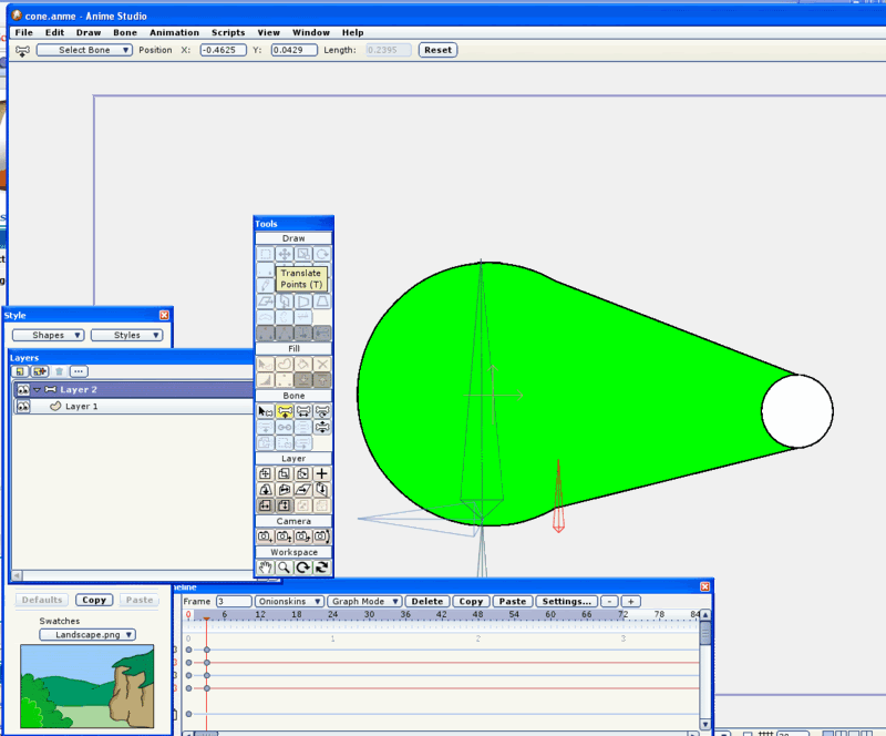

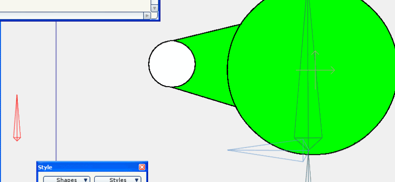

So for example -in order to get the feel of this method I just created a simple cone shape

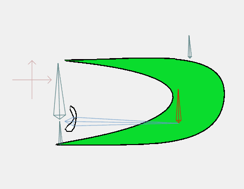

Then I twisted it to see what it looks like from the side
The rear layer is concave.

I can't seem to see what scaling the large bone does. The little one on the end seems to do all the manipulation (see pict)
Scaling the large bone resizes the horizontal bone thus moving the smaller verticle bone parented to the horizontal bone.

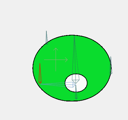

What is causing the "skirt" of the top end of the cone to drag? (Correctly hiding the righthand outercircle.)
The skirt is moving because the points in the skirt and top cone are binded to the verticle moving bone. Are you new to Anime Studio? Have you read the tutorials on Bones and Point binding?
