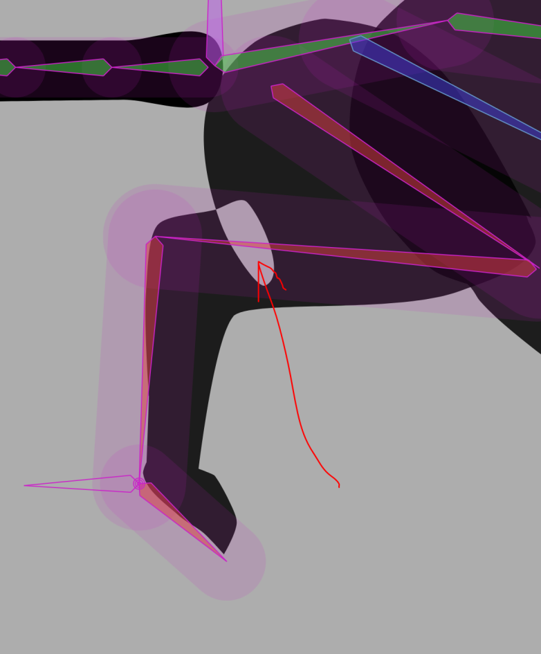

I'm working with a single shape, when the shape is manipulated in a way that the vectors edges create a loop, the filled shape vanishes. I don't want this to happen.
For example where the near-back paw bends it overlaps and makes a transparent shape.

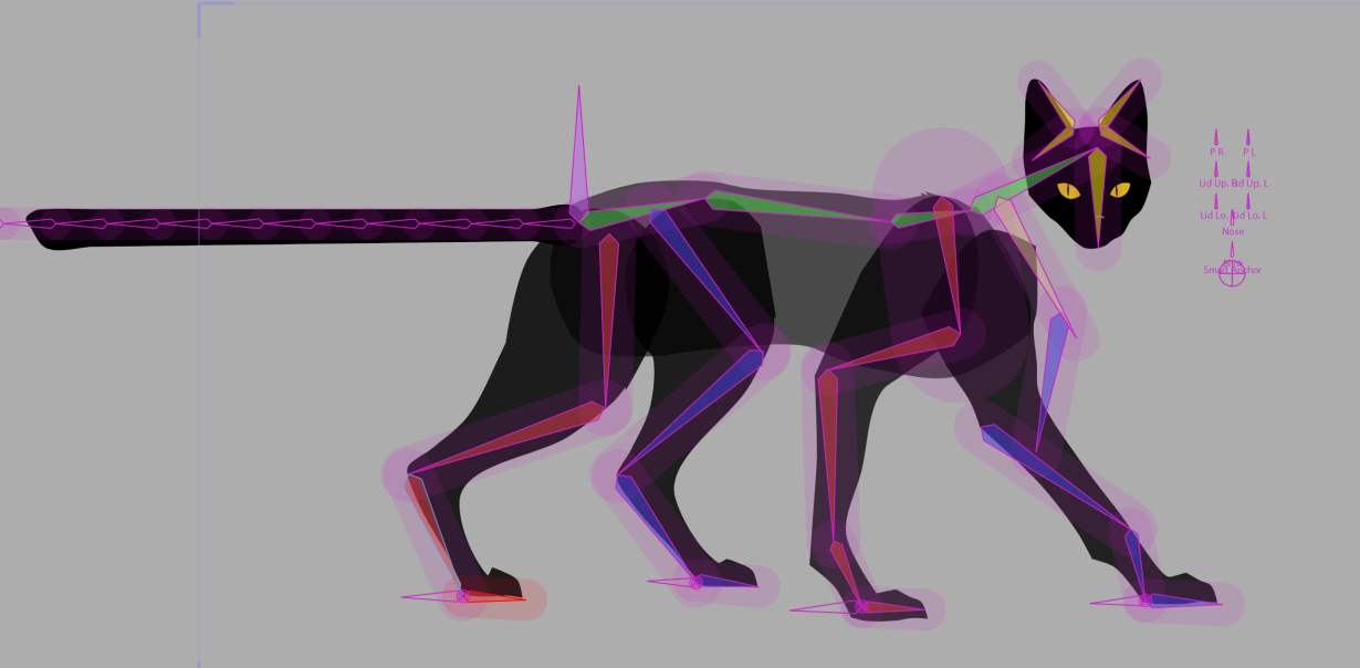

For context, each leg is a single shape with it's own layer, this includes the paw (don't mind the broken bones in the front leg lol).

tac wrote: ↑Tue Apr 07, 2026 8:57 am I was hoping, since she's essentially a silhouette, that there was a way to make the overlap simply stay black without creating extra shapes
When a single shape overlap itself, it always cancels out, so your option is to either split it so it can overlap (the shapes can share the same curves,) or to animate the paw's points so it doesn't overlap.
TBH, when the character is a solid silhouette, as in this situation, making the paw a separate shape (separate curves) and using Bind Points to bind it to the paw bone is probably the easiest and most sensible method. There's actually no need for a Smart Bone or shape-splitting for this. Just make the paw its own element and place it on top.
I would probably make the paw a separate layer completely because I find breaking parts out like this more manageable in Moho, but the result is the same as keeping all the parts in one vector layer.

One more thing: For the cat's knee area, as seen in your first image, I would simplify the drawing (fewer points, as Wes suggested) and probably not use Bezier points. There's no reason this should overlap when the vector art is optimized for this deformation. Smart Bones could help to achieve a specific shape, but it might not be necessary.
