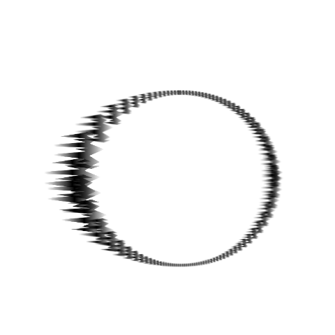

Here's what I got using a brush:
And here's the brush:
But you'd have to have a custom brush for each angle, so it's probably not feasible for dynamic animation.
If brushes had an animated angle setting (not just jitter angle), you'd be able to change its direction to suit the motion.
