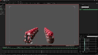

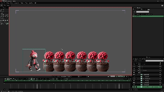

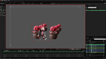

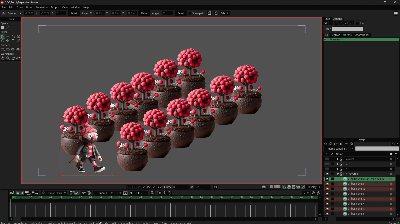

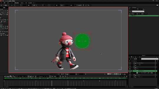

ImageHi everyone, I'd like to share my research inspired by the scripts "LK_SortByYPos" and "LK_SortByZScale" by Lukas Krepel.
To simplify and expand upon these concepts, I've developed a script that utilizes a tagging system within the names of group layers or bone layers. The goal is to automatically organize child layers based on their positions along the X, Y, Z axes, or by their ZScale (where larger scales bring the layer to the foreground and smaller scales push it to the background).
To use this script, simply load the AC_SortByTag.lua script through the embedded script options in a group or bone layer. This script dynamically and automatically organizes the order of layers according to different modes (X, Y, Z, ZScale) based on the tags in the layer's name.
You can rename the group layer as you wish, but it must include one of the following tags: "_X", "_Y", "_Z", or "_ZScale". Additionally, you can add a "_Reverse" tag to any of these to invert the sorting order, regardless of the mode. For example, renaming a layer to "LayerName_ZScale_Reverse" will sort the layers by ZScale in reverse order.
