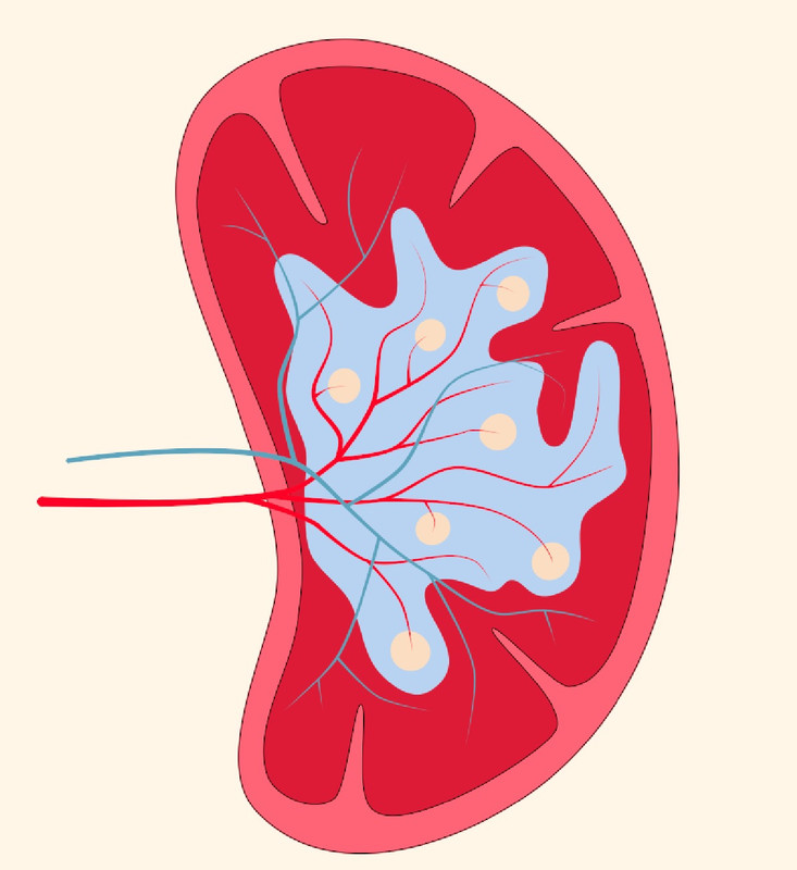

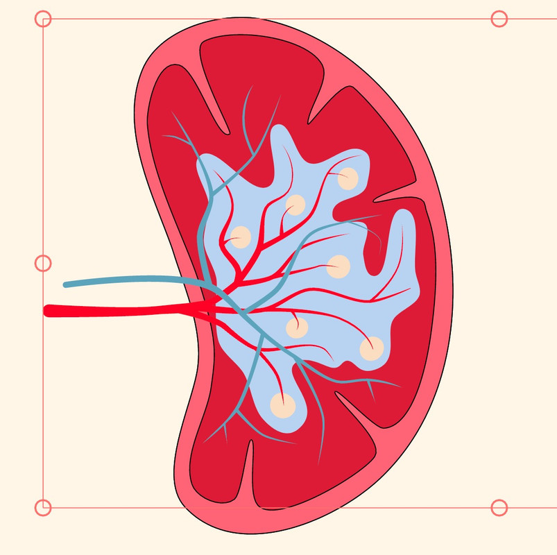

Strokes appear thicker in the workspace than they do on render.
Check out the veins in the workspace here:
And here is the exact same thing rendered:
Scale compensation is off, and so is GPU caching. Any ideas?

The group layer, you scaled it. I think that's why the .7 stroke appears thicker in the workspace.
Maybe un-scale the group layer and adjust the stroke widths?
Maybe there's an easier way.
There's an awesome script called Adjust Line Width that I often use to change line widths.
But it is weird that what you see in the workspace is NOT what you get.

Weird, the problem went away. I'm now seeing what Greenlaw is seeing. That is, the render matches the workspace.
The only thing I did was click the "Restore Defaults" button in the Preview window.
Maybe your Preview is out-of-whack?
