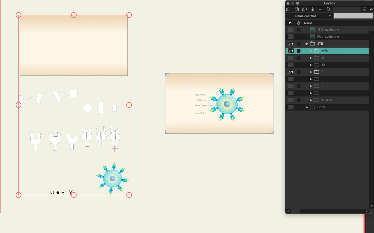

Actually I think I didn't express myself correctly. By "folders", I meant "groups", with just one single file for my entire project.
I was wondering if Moho can handle it, having each shot or scene within its own group. I can easily export each scene as layer comps and keep everything dynamically updated with reference layers.
In this example, all my assets are in one group ((refs"), and I create reference layers when I need them in a scene, which is just a group away in that same file.
Sorry for the mix up in terms previously.
Re: Project organisation
Oh, I see what you mean.
IMO, if the animations and assets are fairly simple and the multiple shots in your production use the same assets over and over, it's probably okay to do it all in a single Moho project.
But for me, personally, my project would get needlessly unwieldy and subject to poor performance and errors. Putting all my shots in a single project would require too much memory and get too processor-heavy, and it wouldn't be much fun to work with.
For projects with multiple shots, especially when the running time is a few minutes long, the best practice is to set up individual Moho projects for each shot. Then, render out your shots and assemble them in a video editor.
BTW, this isn't a 'Moho-specific' workflow. It's a fairly common workflow when using any animation program.
Actually, the following is the common workflow for longer-format animation productions:
I'm already doing all steps in your suggested workflow (and I do edit on Resolve), It's just for #4 where I'm trying to keep every shot in the same file, to be exported separately as layer comps.
There is much more to come as assets in my "refs" group so I hope Moho will be able to handle it.
Otherwise I'll have to separate it into different files. Although I've never tried, it seems Moho allows referencing across files. I may have to try that.
Thanks!
Thanks!
I'm with Greenlaw on this. I tried a "put it all in one file" some 10+ years ago (it was a 2-ish minutes animation) and it was a pain to work with. Since then, even though we do now have layer comps, I break everything into multiple files, sometimes only 2-3 seconds. Shared resources go in their own .moho which is never directly rendered - just groups (now) imported by ref into "shot" files.Nicohk92 wrote: ↑Tue Apr 30, 2024 7:51 am I'm already doing all steps in your suggested workflow (and I do edit on Resolve), It's just for #4 where I'm trying to keep every shot in the same file, to be exported separately as layer comps.
Thanks!
