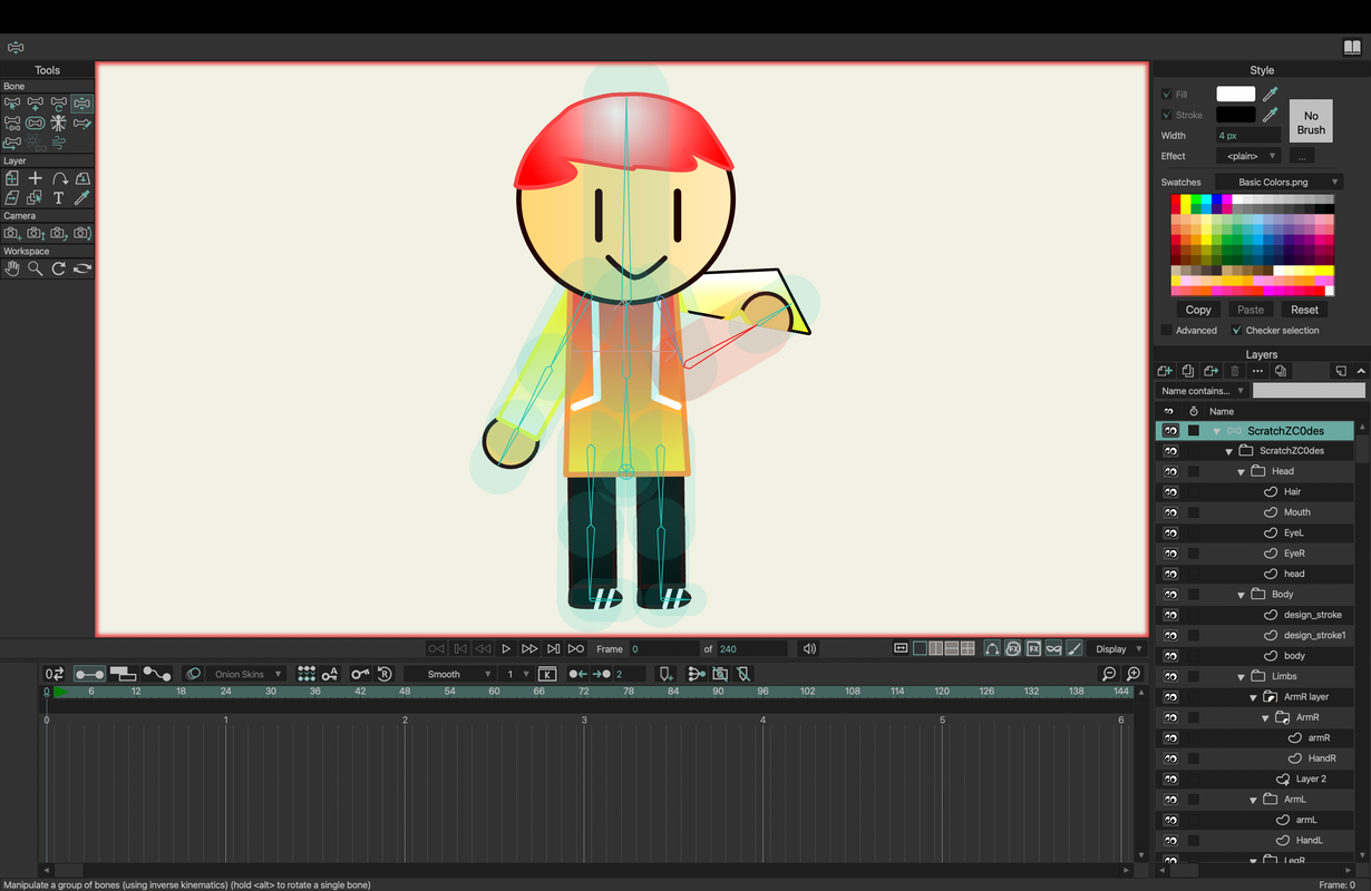

I'm not sure if the way I'm doing it is correct, is it correct?
Re: How to stop gradients from being moved by the bone
Hard to tell but it looks like you didn't bind the arm itself. There are lots of tutorials on rigging a character. Start with basics try flat colors first get everything moving the way you want then add the gradients. Either the way I explained or the video I posted. All these things get easier with practice Goodluck

The character I made was created in another software (Inkscape), So I don't know much about gradients in Moho
I binded the rectangle but it's movement was still pretty weird (Note: I'm using a smooth joint pair) So i'm still not sure what I need to fix
Maybe it's my layer order, the way the gradient is idk, but the rectangle just hides the arm when I move it
