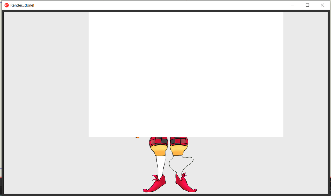

Popa wrote: Sun Oct 22, 2023 1:49 pm This is how it looks before render:
After:
Hmm...so, it looks okay in preview but renders chunky? That's a new one to me.
Are you exporting PSD from Krita? If so, what are your export settings?

You mean export settings from Krita to Moho? I havent changed anything, just basic I guess. PSD
I'm gonna redo the layer in question and see the result. Everything else seems fine

The red shoes seem fine, only the legs are wonky. Do you have a brush enabled for the strokes of the leg shapes? I could simulate that result with a brush if I increased its spacing.

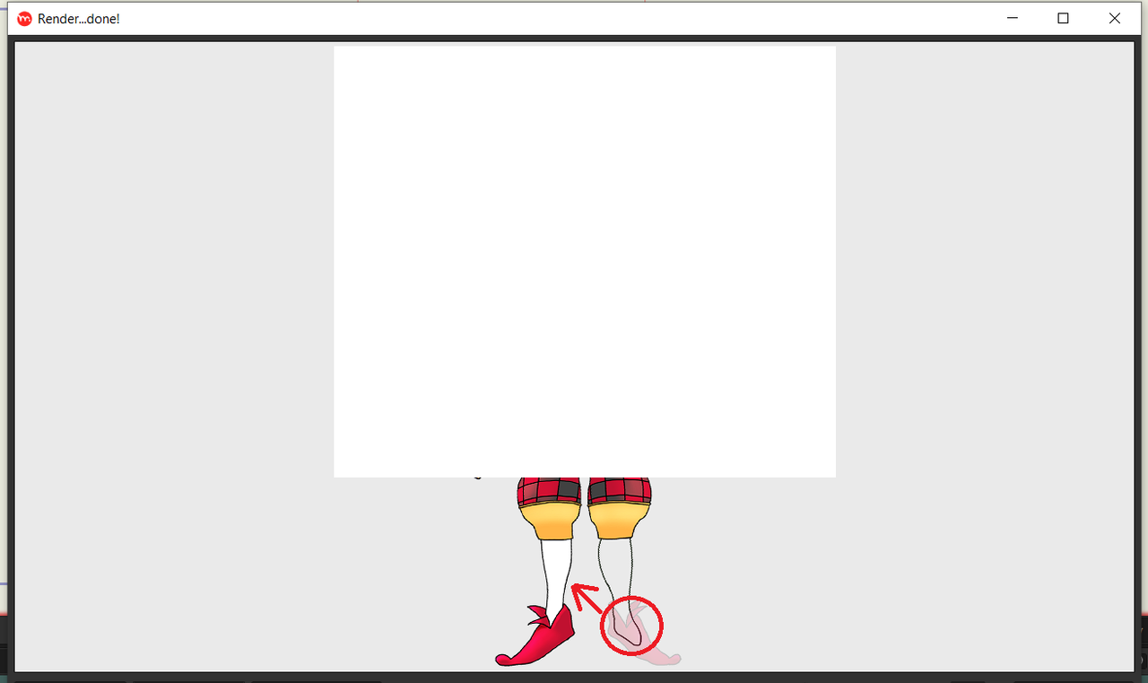

I used animation preview which prevented me from seeing a clear picture because of movement. Just 'preview' like you mentioned is much better, sadly it shows there once again the problem. The picture looks clear but after render it goes downhill for my lower legs. New layer which I replaced with old one doesnt help.
There is good news on my part. Im seeing much better quality when I lower the scale on my img, everything turns sharper except my legs. lol God these lower legs are annoying.
Just to confirm, your option "preview" shows us the rendered version right?

Thank you for clarifying that. My render or preview does exactly the opposite, it ruins my image. I produced some videos yesterday and confirmed that.

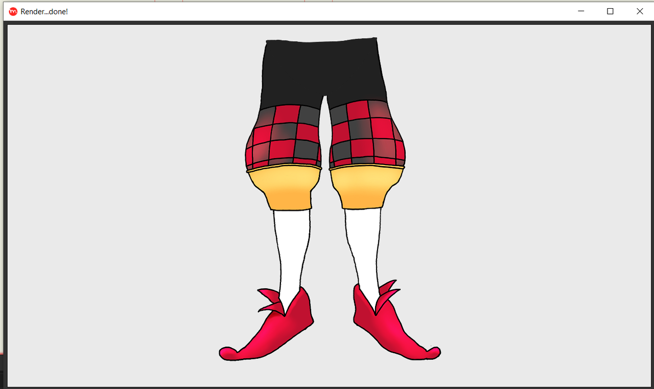

Here is how my workshop looks like. 720x960 scaling, one lower leg is thicker because I used a different brush now, but with no succes.
Here is my render.

Popa wrote: Mon Oct 23, 2023 1:44 pm. . .one lower leg is thicker because I used a different brush now, but with no succes.
What happens when you choose NO BRUSH, and only use the basic stroke?

I will test that out tonight. Im very sorry for slow reply, short on time these last 2 days. I did find out maybe this is scaling related afterall.
I took only the pants and made it as big as possible on my workplace and it looks fine now.
For some reason my lower legs take the biggest hit when it comes to scaling, by far the biggest, meanwhile it has the same elements as my other layers, nothing special was added.
My true size for my character design goes like 2500x2000, no matter what scaling after that I cant make it work, meanwhile other layers are adjusting fine. What makes this even more odd is that it looks better before render on my workplace.
