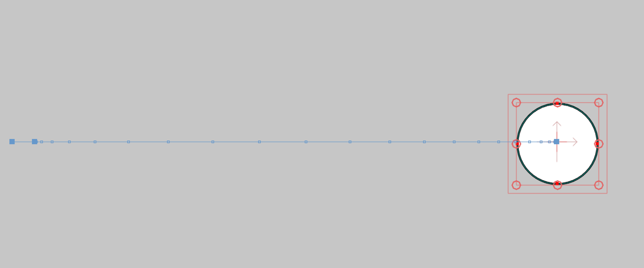

Saw another discussion about Ease In/Ease Out Parameters and while i think Moho uses the correct terminology, i just noticed that no matter whether i ease In or Out of a Key into a linear one, it always adds cushioning on both keys...
Here the first key is set to "Ease In" and the second to "Linear". As you can see though, it slows down both at the beginning and the end. With an Ease In on the first key, it really should be full speed at the beginning and then slowing down at the end.
If i change the Interpolation to "Ease Out" it does pretty much exactly the same thing.

JoelMayer wrote: Mon Jul 31, 2023 3:35 pm Saw another discussion about Ease In/Ease Out Parameters and while i think Moho uses the correct terminology,
to make sure we're not at cross purposes -- Moho uses "ease in" to mean "Create a smooth transition at the beginning" (i.e. moving into the transition) whereas (e.g.) After Effects would call that "ease out" (i.e. easing out of that keyframe). Both have some logical explanation in the light of how the keyframes "work" (moho's keyframe controls the time/value curve from it until the next; whereas, if I've understood it properly, AE's controls the time/value around it - from "midway" between it and the previous to midway between it and the next???)
JoelMayer wrote: Mon Jul 31, 2023 3:35 pm i just noticed that no matter whether i ease In or Out of a Key into a linear one, it always adds cushioning on both keys...
yep -- found that too. Doesn't quite match what's in the manual...
