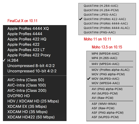

The different quality settings of the various ProRes flavours remain a mystery to me. And they're different from program to program even on the same machine! See:
As you see, FinalCut offers more options than Moho on the same machine on OS 10.11. I don't use them anyway though.
The option naming of Moho 13.5 on OS 10.15 is a bit misleading. "MOV (ProRes alpha-ALAC)" creates a .mov file which is Appple ProRes 4444, as it reveals in the Finder info.
