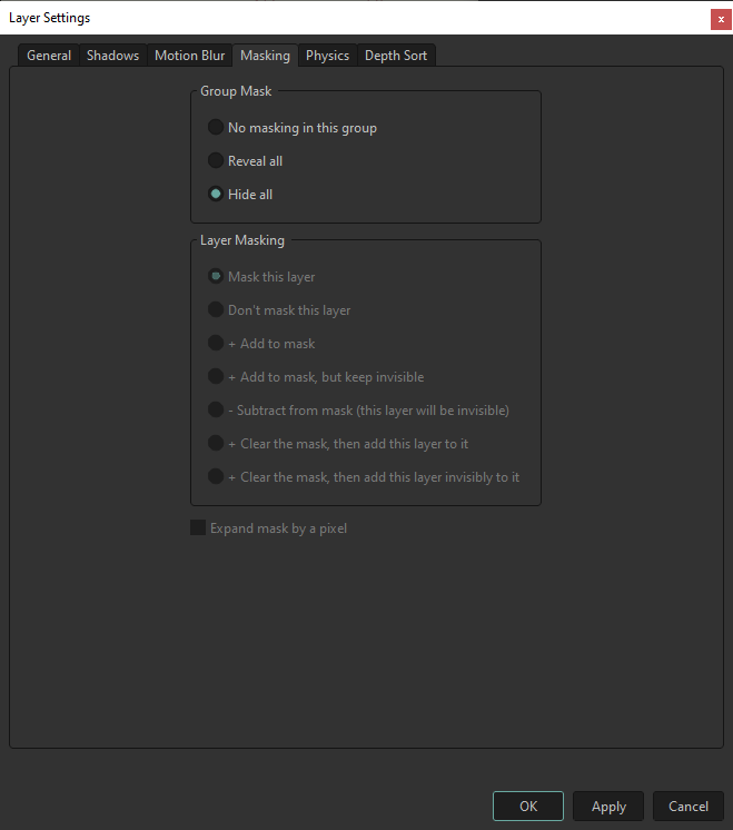

-Daxel's suggestion of extending the mask seemed promising, however, it was grayed out the in the layer settings.
That setting, as the other "layer masking" settings are availible for the layers inside the mask group, not the group layer itself. You could try to apply it on the layer that is acting as the mask, that has that plus (+) icon and its mask settings say ·Add to the mask.
If you weren't familiar with these settings, exclude strokes is another useful one, it could help you to retain the stroke of the leg on the part where the pants are scraped, if you want.

I will also attempt expanding the mask on the individual layer and see if that has an effect. In retrospect, it seems so obvious that it wouldn't work on the group, I feel kinda silly. whoops-
Daxel, I applied the expand mask by one pixel, which increased the line, so I think at the very least that solves the mystery incontestably for me- Now I just gotta get them to add a contract by one pixel button! Come to think of it, it's a feature I used to use pretty regularly in photoshop so it probably would have some value!
