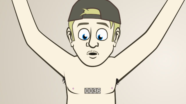

Well, since I've recently started scripting I decided to give this one a go.
The result is here: http://www.dauid.com/tools/scripts/ds_framecounter.zip
EDIT: Discovered that it didn't work in AS 6.2 so here's a version for Anime Studio 6.2: http://www.dauid.com/tools/scripts/ds_f ... ter_62.zip
It's a menu script so put it in *anime studio directory*\scripts\menu\Third Party.
And this is what it looks like:
It uses switch layers for numbers and creates keys between the selected start and end frames of the project.

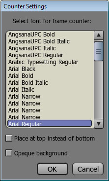

Things to do:
*Fixed*Make selectable font (right now it uses Arial Regular)
*Fixed*Make a better default position when it's created. Now it's created in the middle of the screen.
*Some other stuff.
