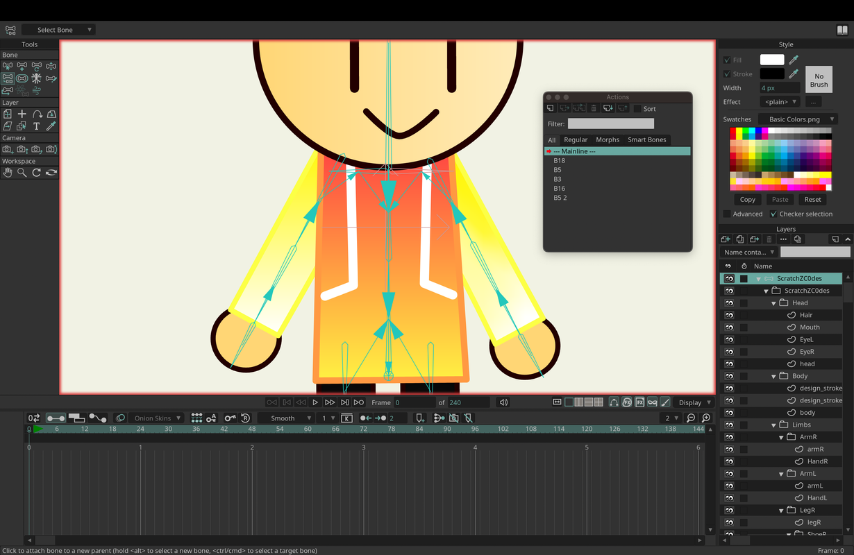

I can't really see the arrows and where they're pointing at in your rig, So here's an image of the parenting structure on my rig:
Maybe from here you can tell me what I need to do!

Just to clarify my question a bit more, how would I make the arm R and L bones move up with the head when it looks up or down without the rest of the arm moving along?
