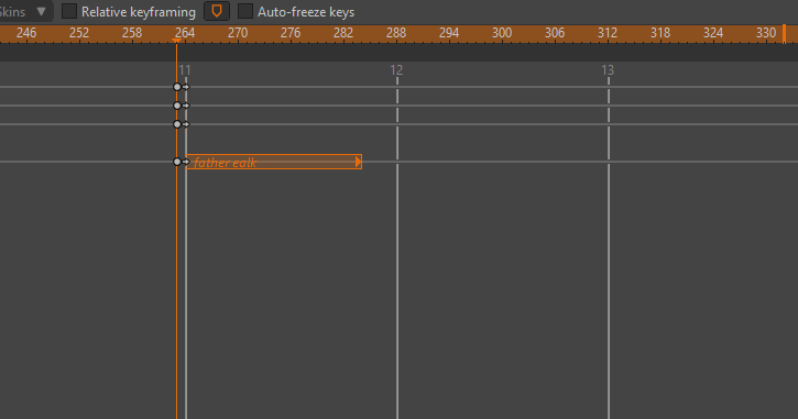

I have new suggestion. like what I see we just can highlight time line with color and write some info about what's happened in highlighted areas .
for instance: father jumps and say hello.
Posts: 1093
Re: LK_SwitchMarkers (Show switch sub-layer names on timeline)
davoodice2 wrote: ↑Sat Aug 21, 2021 6:01 am great idea.
In case you don't know about them: you can place markers on the timeline and give them names. It's not displayed exactly like you described, but the purpose is the same, to put notes in the timeline. And you can choose to show those markers on the entire document making them visible on every layer, so you dont have to place them on every layer involved in the "father jumps and say hello" animation.

Daxel wrote: ↑Sat Aug 21, 2021 6:59 am
yes i know that. but it was a better if it was.
Posts: 1093
davoodice2 wrote: ↑Sat Aug 21, 2021 8:06 am
Well now that I'm checking it, it basically works as you described. I didn't know that, but checked the manual and discovered this:
"Timeline marker regions are based on the keyframe’s hold values." "You can manipulate markers just like any other keyframe type."
So I tried holding alt and left-clicking on the marker dragging it to the right to increase its hold value over the timeline like you can do with a normal keyframe and it works, and actually highlights the portion of the timeline. And you can change its color, give it a name... is that what you wanted?

Daxel wrote: ↑Sat Aug 21, 2021 9:16 am
So I tried holding alt and right-clicking on the marker dragging it to the right to increase its hold value over the timeline like you can do with a normal keyframe and it works, and actually highlights the portion of the timeline. And you can change its color, give it a name... is that what you wanted?
yes that's it. some thing like this but for marker.
Posts: 1093
davoodice2 wrote: ↑Sat Aug 21, 2021 9:30 am
It looks fairly similar
https://1drv.ms/u/s!AiyKCw6Xey5TgZUboLs ... w?e=m3ilbZ
By the way, to extend the marker dragging it it's not alt+right-click, but alt+left-click.
