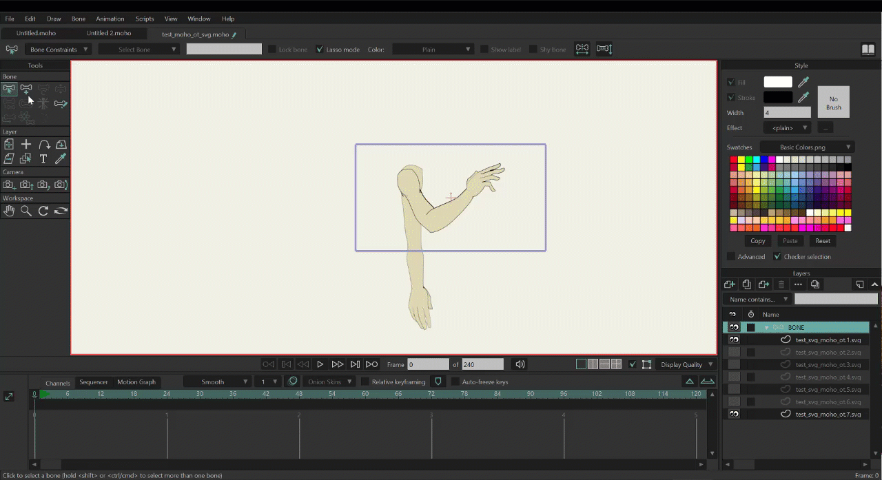

I tried again but, i dont know why that not works.I tried to check enabled but it doesn't seem to work. Even after selecting manually. I made a gif here i tried to follow the manual's instructions:synthsin75 wrote: ↑Fri May 14, 2021 9:57 amIf one bone doesn't have the v-bone symbol, select it and the one that does and hit the + button on the v-bone tool. If v-bones don't disappear as expected, make sure "Enabled" is checked on the v-bone tool.

Check your bone parenting. You go from creating the hand bone for one arm to creating the upper arm bone of the other. Bones in the same parented bone chain cannot be v-bones. Make sure your straight arm is parented to your body bone, like your bent arm is. Also, you show binding the same art to both bone chains, when you will need to bind different art to each chain.neophite wrote: ↑Sat May 15, 2021 1:19 amI tried again but, i dont know why that not works.I tried to check enabled but it doesn't seem to work. Even after selecting manually. I made a gif here i tried to follow the manual's instructions:synthsin75 wrote: ↑Fri May 14, 2021 9:57 am If one bone doesn't have the v-bone symbol, select it and the one that does and hit the + button on the v-bone tool. If v-bones don't disappear as expected, make sure "Enabled" is checked on the v-bone tool.

synthsin75 wrote: ↑Sat May 15, 2021 1:54 pmCheck your bone parenting. You go from creating the hand bone for one arm to creating the upper arm bone of the other. Bones in the same parented bone chain cannot be v-bones. Make sure your straight arm is parented to your body bone, like your bent arm is. Also, you show binding the same art to both bone chains, when you will need to bind different art to each chain.neophite wrote: ↑Sat May 15, 2021 1:19 amI tried again but, i dont know why that not works.I tried to check enabled but it doesn't seem to work. Even after selecting manually. I made a gif here i tried to follow the manual's instructions:synthsin75 wrote: ↑Fri May 14, 2021 9:57 am If one bone doesn't have the v-bone symbol, select it and the one that does and hit the + button on the v-bone tool. If v-bones don't disappear as expected, make sure "Enabled" is checked on the v-bone tool.
Okay! that was the problem thanks, it works perfectly now.
