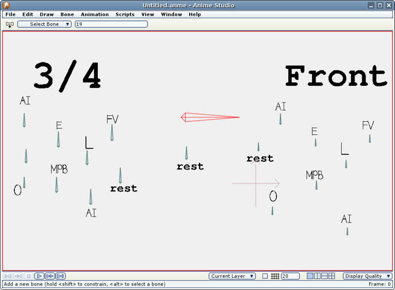

Am I correct in thinking that we can't use additional facial bones to adjust expressions in the time line after the poses have been layed down?- unless they are part of the pose already? i.e. eyebrows, jaw etc.:(
Anyone wanting to try the full pose array, can use this example file, and adapt it to make you own 'better' faces or objects.
http://charleskenway.com/anime/fullposeface.zip
Posts: 10273
Great work Genete!
Yeah Chucky, it doesn't work for bone motion.
I have one suggestion which may help this slight deficiency. You already have 'boneselector' to choose your poses in the array. It would be nice if you could have secondary pose selector bones. Basically several separate arrays on one layer.
Like perhaps a 'boneselector_b' that only works with 'pose1_b', 'pose2_b' etc.
Just an idea. :wink:

OK the backup is already done. I think that all the scripts MUST be pasted in the post itself instead of place a link to an external file. Anyone who would use a script should know how to save the portion of text and give it the proper name.
Darthfurby wrote:Genete: Here is my proposal: I will create a pose bones head turn model of your choice from any character in my gallery, AND make a video tutorial/promotional video about the script, if you can fulfill my feature request, which is this:
Your models are lovely Darth but I prefer to use a simpler model. Maybe something like the one that chuky did recently. It wouldn't be hard to me to create the model in the needed poses. I take your proposal to create a video tutorial, though.
Darthfurby wrote:The ability to key/adjust the pose bone and point motion at the same time anywhere on the timeline, including the following channels:
Point Motion, Selected Point Motion, Point Curvature, Selected Point Curvature, Fill Color, Selected Fill Color, Line Color, and Selected Line Color.
I don't know if it's possible, but I'd love to see it happen.
Point Motion and Selected Point motion: what do you exactly mean with selected point motion? are you suggesting that the script would only take care of the selected points when it runs? Mmm it is a good idea but I don't see any application on it for the moment. It is just another if then condition so it is not difficult to do. If no point is selected then it should consider that all they are affected as it works now.
Point Curvature and Selected Point curvature : It is possible too and easy to implement because the interface is related to the Curve Object (easy to obtain from the script interface). The problem is that I've not tested if the interface would change the object value (curvature) without add any keyframe or it would add a keyframe every time the function is called.
Fill Color and Selected Fill Color, Line Color and Selected Line Color: Current interface would allow access those animated channels by the Style property of each shape (outline or fill) but I think that you only can select a shape a time. Using fazec's tools you can select several shapes at once but only the first is affected by the modifications you do by the style palette. Anyway I would try it. Also I don't know if the script interface would produce a keyframe or simply would modify the value during time.

Joined: Tue Oct 17, 2006 3:27 pm
OK, OK here it is:
http://www.darthfurby.com/genete/Scripting/poses2.zip
This zip file includes:
poses-2.0.lua
New version of the embedded script
modeltest.anme
5.6 anme file of a beautiful model form DarthFurby used to test the script.
/Poses/ge_toggle_keyframe_poses.lua
A menu script needed to allow create keyframes when the script runs and not only move the points. It only do keyframes for point motion. Usage: Copy this folder in to your scritps/Menu folder and reload (CTRL+F5) Anime Studio scripts.
News:
  • I've added some testing to speed up the positioning on the poses. You can edit the poses freely staying at its own frame but if you modify a pose then you have to go to frame 0 to store the modifications on the pose array. Frame 0 is slow!!!
  • Now the pose bone length has influence on the final weight of the poses. So you can control the interpolated pose with the poses lengths.
  • Added the Curvature channel. Now the curvature is stored and is interpolated between poses. It produces automatically a keyframe on each frame. There is NO WAY to solve this because the curvature channel has not a fCurvature variable to set like the one for the points.
  • Added the functionality of an external variable: GE_ToggleKeyframePoses.Status
    You have to run the ge_toggle_keyframe_poses.lua script by the menu or button script to modify the variable Status form false (default value) to true and vice versa. When this variable is set to true the interpolated point motion is stored in a keyframe. This is useful to store all the animation in its own keyframes and be able to remove the embedde scripts. Also useful when used on single frames to key all the point motions for all layers where the script is embedded.
  • Added the ability to avoid interpolate or set again an existing keyframe. This allows the user to insert a keyframe in any moment of the interpolation and manually modify the interpolated values. This solves the situation where the interpolated poses produces a bad value difficult to solve by modifying the poses themselves.
If you carefully look to the modeltest you can see how the curvature of the point of the nose changes along the keyframes. Also some points of the cheek.
Regarding to the new functionality of be able to produce its own point motion instead of the interpolated by the script. I have to say that I discovered it accidentally. What a good surprise!!! Using the script normally you can now move any point at any moment and the script automatically would pass over that keyframe and would work in the rest.
Please test it and let me know.
