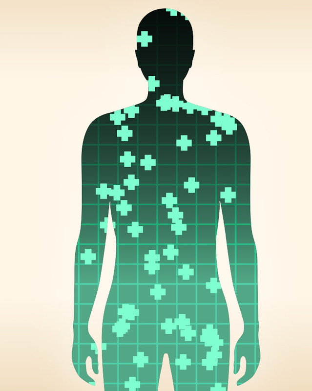

I'm trying to get a shape replicated at controllable intervals, or at least with enough control so that they are somewhat evenly spread around without superimposing onto each other.
What would be fantastic would be a tool that can distribute instances of a shape on each points of another shape (there's a geometry node like that in Blender, or a similar effect in Apple Motion called Replicator).
I tried doing it with those green crosses using a particle layer, but no matter the settings, they keep overlapping. If at least I could have them not being on top of each other. Maybe with a brush?
I can't believe I may have to resort to another software to achieve something that simple.
Posts: 4023
Re: Replicate without overlap
two ways I can readily think of:
scatter brush -- draw your cross (any size); select the shape and copy; then set the scatter brush _options_ to be all zeros except Spacing which you set to greater than 1: about 1.5 to 2 worked well for the quick test I ran. Set the max and min sizes to be the size you want (e.g. 75 px); then drag the mouse around -- yes, ok, you need to avoid running into a previous shape you've created.
custom brush: set the spacing to be more than 100%, draw lines -- you may need to tweak some point placements because the brush stamps might overlap when you get to a control point.
hope that helps
