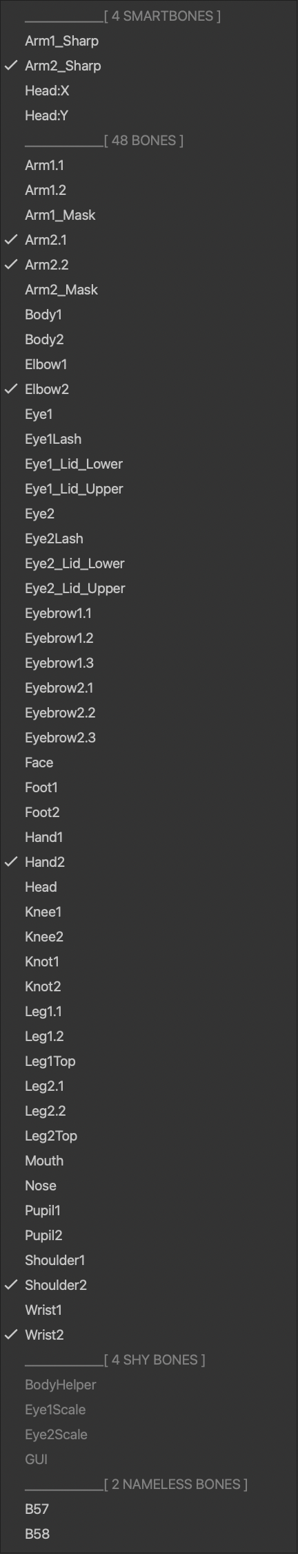

Here's a screenshot of my custom Select Bone dropdown, not only alphabetically sorted, but it has categories. (By the way, PLEASE sort styles alphabetically too, if any dev is reading along)
Weirdly enough, the unnamed bones section one is most useful to me, so I know which bones are not named or accidentally created super tiny bones... I like to force myself to name all bones so animation is easier to copy from rig to rig.
Checkmarks show which bones are selected and greyed out are hidden. The dropdown replaces the original dropdown in the select bone menu, but of course overwriting original functionality is hack and not great.
