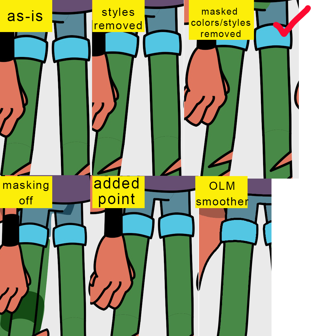

Hey everyone -
Thanks again for all the great suggestions! I rounded them up and did a side-by-side comparison. I will also kinda elaborate here in the reply:
-Firstly, there's an image of the character, as-is (I made a few changes to the shape of the thigh from the previous version.
-I also included an image of the left leg with masking turned off, so you can get a sense of the shape that's being masked. It's much larger than the shape of the leg, and the colors are set to multiply. I'm doing this so I can retain the linework from the bottom (mask) layer, which I have colored white. I had a reason for the multiply setting but I honestly don't remember what it was.... This masking was mainly necessary to achieve the torn look of the leggings, as pictured.
-Daxel's suggestion of extending the mask seemed promising, however, it was grayed out the in the layer settings.
-I removed styles from the masked shapes to start. I then color sampled the green. This had no effect, but not surprising, as it is beginning to look like the multiply setting is causing the issue.
-I then completely removed the masked layer altogether, and used the colors in my base layer. I'm not sure if the styles really had anything to do with it, or if it was just the fact that I got rid of the multiply setting.
-The added point also had no effect, but for rigging purposes I usually overlap the edges anyway, so edges already had a pretty healthy overlap to begin with.
-Lastly, I tried OLM smoother with AE on an aliased render of the character. I love the idea of this plugin - I use AE for comp so I'm happy to use it - The results, however, were far inferior to the rendered result with Moho's built in anti-aliasing. OLM had a ton of great other plugins though so I am still very stoked for that info!
verdict: I think in this case the issue is a combination of the multiply layer setting and the "stacked" shapes as mentioned by a few of you. While I can work around it on this rig, I think there are plenty of instances where I will need to set a layer to multiply in a mask group, so I'm curious if any of you have thoughts on reliable workarounds in the future? I for example, use multiply and masking often for shading on characters, so I can revisit old rigs as well to see if that also caused the issue. I most certainly have had the same issue that Greenlaw recreated in other rigs I've built as well, and I have assumed the cause to be the same, but I believe in this case it is different, and was a multiply issue and stacking layers.
If anyone still wanted a crack at the rig feel free to send a Private Message and I will send it over- While I feel like I know the cause now, I still don't totally understand why it's happening.
