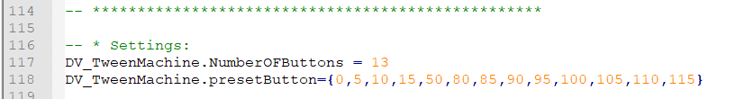

This is my previous Tween machine script with some improvements.
1- add preset buttons
2- add tweek buttons (firstly apply percentage with one of options you with and next use tweeks button to add 1 by 1 (or 2 by 2 if hold alt.))
3- remove unnecessary options.
*use Alt while pressing presets , applies reverse values (eg 5 >>> -5)
*use Alt while pressing tweek applies tweeks with doubled value.
U can change preset buttons count and value of preset in script easily (just see line 117 and 118)
