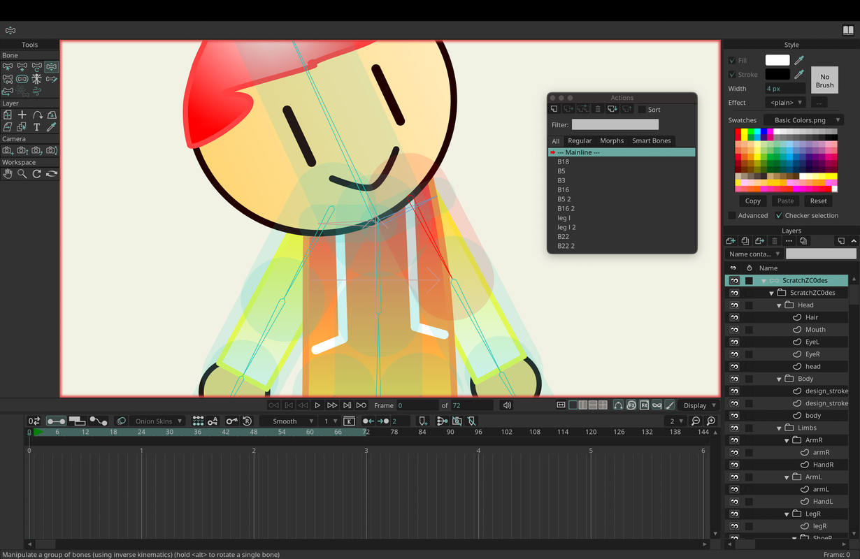

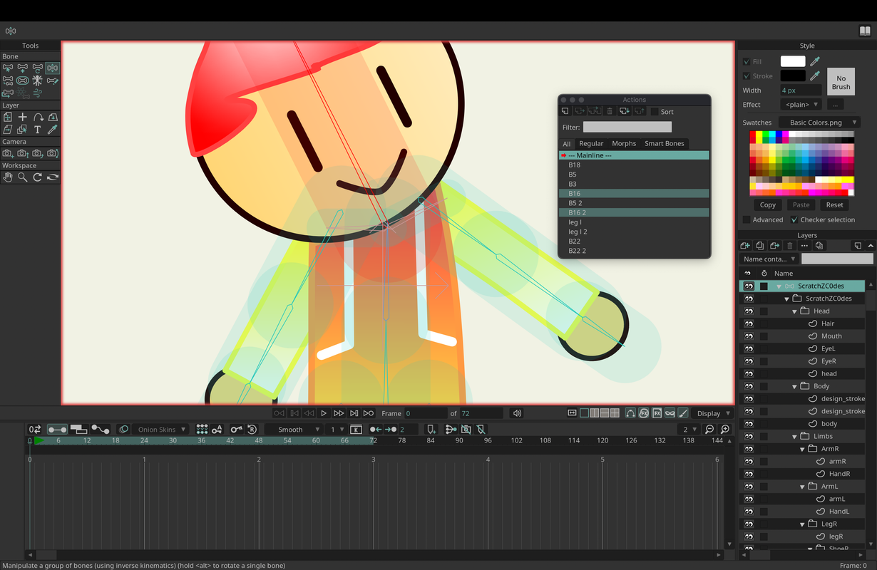

So here's a demonstration of what I've got so far:
This is what I have:
And this is what I'm trying to achieve. This is also the result I got by making the top arm bone have an independent angle (but I wasn't able to move the top arm bone when I enabled this):
Anything else I could try? And is it actually possible to make smart actions with bones? (e.g, moving the arm bone up when the heard turns left or right in the smart action)

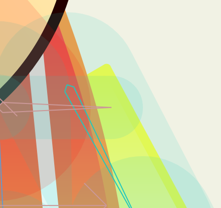

I'm not really sure which option I should pick nor am I understanding them quite well
. Will a smart action involving the bone do the trick? All I need for the head looking up or down, is the upper arm bone rising up along with it, to prevent something like this:
temporarily disabled my clavicula bones to replicate this btw
